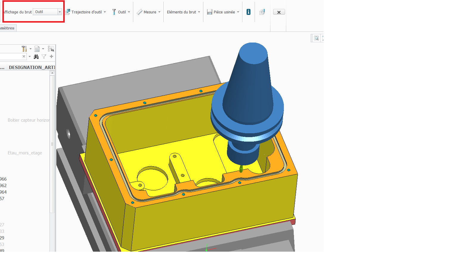

Hi Steve,
You can have colors for the different sequences or different tools by selecting in the box as in the image below
Aug 19, 2016 2:22 PM UTC
Raphael, Thanks for the Info!!
Lack of training or help files bites me again!! I thought it must be able to do it Just have to know where to look or have time to look.
