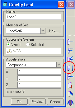

I'm working with Pro-mechanica wildfire 4 and O want to calculate the flexion of a shaft according to is own mass
please can you give me the method to follow ( or better a tutorial )

Olivier,
You need to apply a gravity load:
Then make sure that your material has the correct density, and that your shaft is constrained in an appropriate way.
HTH!
