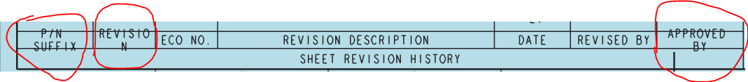

Hi, guys, our company requested us to use Creo 3.0 recently, and we found below two issues very boring related to Creo drawing, anyone have any idea about how to solve them? Thanks.
1. When we use Creo 3.0 to open the drawings that we created before by Creo 2.0 or older version, some letters becaome bigger, not suitable for the table anymore, see below picture, those letters are all within the table cells if we open the drawing by Creo 2.0, this is very boring, cause we have to change the font size one by one everytime if we need to update old drawings.

For (1), it is generally that a drawing must retrieve just as it did in the previous release. Could you file an SPR with Tech Support, so we can figure out the cause and fix it up?
