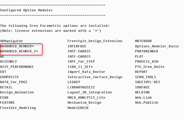

In training institute we are using creo academic version M010. but i want to use creo advanced rendering. how do i check whether its having ARX or not? also tell me what is the advantage of ARX while comparing to normal creo version? and what is the difference between photolux and ARX?

Go to "File" -> "Help" -> "System Information.  scroll down to configured option modules and look for "Advanced_Render" and "Advanced_Render_2"
What is ARX? -> 3D CAD Rendering Software | PTC
Basically ARX just adds a "better" renderer, and allows more capabilities using the shaded with reflections mode.
