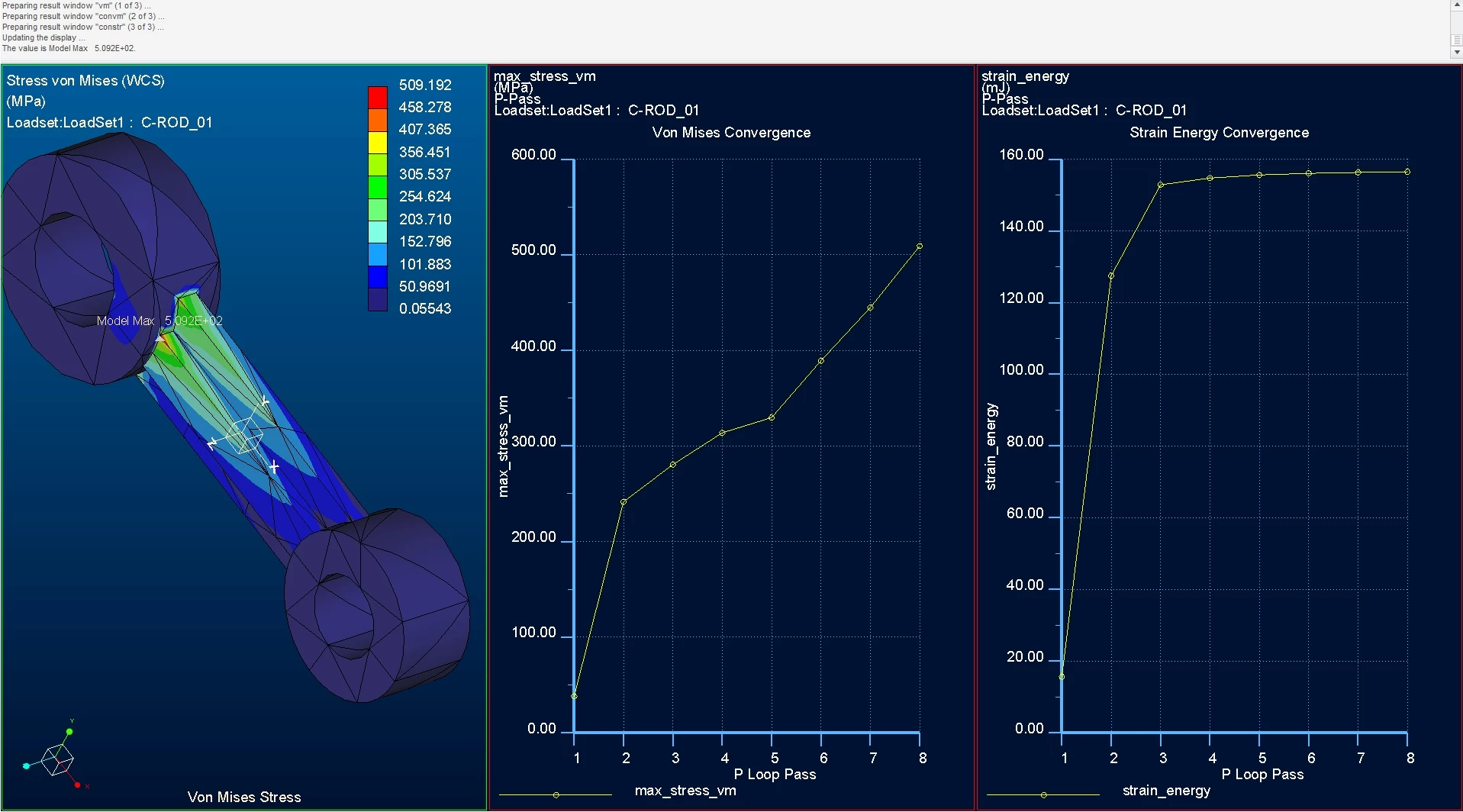

I’m having a bit of a hard time with this. I seem to have a singularity, and I can’t get away from it. I’ve done a few simple models akin to what I’d expect here at work, and each seem to have convergence issues. I’ve tried various methods, but it’s always there. My Von Mises graph is always rising, although some to a lesser degree, always rising.
Today I’m attempting the ‘connecting rod’ model from the ‘Toogood’ book, Creo Simulate Tutorial. Of numerous analyses run, my singularities are always one of the two points highlighted. No matter how I try to isolate these corners/points, I can’t get convergence. I’ve tried multiple attempts at excluded edges & points and re-entrant corners. I’ve even been playing with mesh sizes.. Nothing seems to correct, or lessen the convergence rise. Mind you, I am getting better at knowing what to turn off, what to turn on, and what / how that affects the results.
I’m currently playing with the geometry, and adding rounds to the 90° edges. While that does improve things, I don’t’ feel it’s quite the right thing to do.
I am at a bit of a loss to explain, or rationalize what I’m getting..

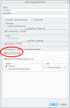

I think you are being misled by system global measures and perhaps some more info on 'isolate for exclusion'. Hope this helps
Ensure that you have excluded elements selected in the analysis definition form (sounds like you have)
Your graph shows 'max_stress_vm' measure is plotted. This is a 'hard wired' measure and it reports the maximum numerical value of vm stress in your model and disregards location. From pass to pass, the numerical solution can also cause the location of the highest numerical value to move about. The global system hard wired measure you have used doesn't care about location.
In your model, the global max of vm stress measure you have used will 99.999% of times be at the sharp corners regardless of whether you have 'excluded' elements or not. The graph of these stresses is not going to be useful. (Other than telling you that there is a very high stress likely at that location and you must rationalise its existence or manage it by design change)
If you want reasonable numerical stresses at these locations then you need reasonable approximations of geometry at these locations. i.e. put a round in, a tool tip radius say. Refine the mesh at this new geometry ...
Excluding elements only removes the elements that touch the edge (or other feature) from the convergence calculation. Your elements are big and cover a lot of structure beyond the offending corner(s)... easier to provide a links to Tad's blog here ...

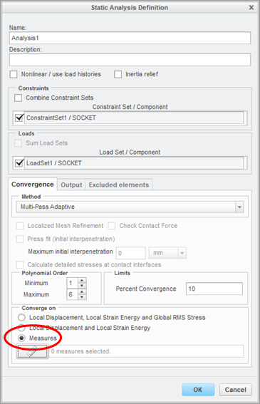

2. Confirm the convergence at more useful locations. Create measures to record the stress/strains at some more useful location and converge on this (these) measures rather than the 'global' and 'system hard wired' measure and converge on these measures instead. Do this from within the analysis definition form (below).
3. Refine your approach to exclusion and don't exclude the elements from the convergence calculation you should include. Don't forget, you can get fancy with volume/surface regions together with various autogem controls to bound offending edges etc.

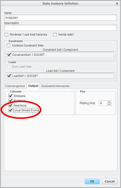

4. Ask for Local stress errors in the output tab of the analysis definition form (below). (this output is switched off by default and if you don't ask for it you don't get it * ) Plot the raw errors and examine your intended area of study to confirm that these errors are reasonable.

I almost never use the built-in measure "max_stress_VM" because its value will always be corrupted by a singularity to the point of irrelevance. It is as meaningless a number as the number of seconds since your last birthday. Trying to get it to converge is like chasing smoke. As has been pointed out, it is also sometimes mesh dependent, and its location can sometimes jump around with each pass or new mesh. Better to instrument your model with measures that avoid the singularity location(s) that are meaningful to the question you want to ask. Then converge the solution on those measures - this is the best way to set up as efficient and effective model as possible. Beware of brute force solutions, like putting rounds on every edge or re-entrant corner, or remeshing with finer and finer meshes, since these are often overkill (and won't catch the smoke anyway!).
