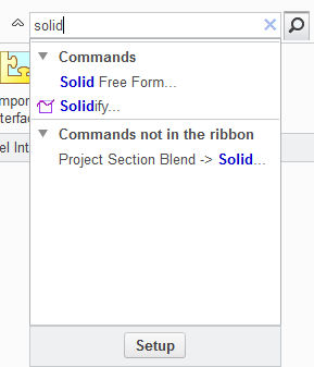

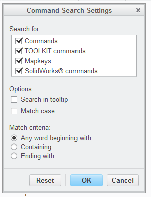

Here's the first bit of help I'd suggest (while you address the s/w conversion or training issues). Use the Command Search in Creo. Turn on the Find Solid Works command option for it. Now when you want to do something, type in the command you would use in SW and let Creo tell you where the Creo command is.
Here's how to do it:
  1. In the top right corner, expand the Command Search window by clicking on the magnifying glass
  2. Start typing something in the box, like "solid", when the window pops up with the dynamic search results below, select the "Setup" buttonCapture2.PNG
  3. Turn on the SolidWorks Commands, and select OK.
That should be a pretty big help.
