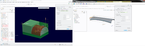

I tried to trajectory mill with 3 axes in PTC Creo 3.0 a contour (see image below) like in this tutorial explained:
Tutorial: Using the User Interface for Trajectory Milling
The problem that occurs is that the cutter stays in z-direction at the reference plane and does not follow the contour in z-direction. It is only 2.5D milling and not 3D.
Any idea how I can change this?
Here's a screenshot of the settings:
http://www.imgbox.de/users/public/images/5BEHscQJLI.JPG
Many thanks for your help!
Jun 23, 2015 7:32 PM UTC
You need to have start height and height both selected and a step depth parameter set.widget101.bmp
