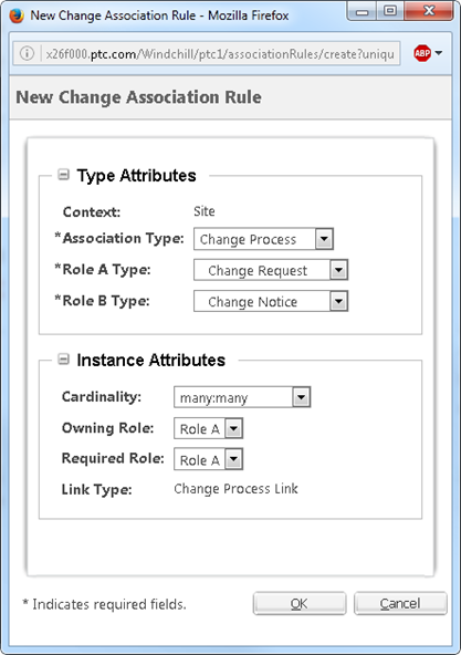

There is an updated version of the presentation with an added sub-bullet on slide 16 that should answer the question of how to implement the "Change Notice without Change Request" preference functionality with flexible change rules:
–Required Role – Identifies associations between objects that are required.
•For example if there is a relationship between Production CR and Production CN
with Required set to Role A then a Production CN cannot be created without
a Production CR that is related.
Site > Utilities > Business Rules > New change association rule
