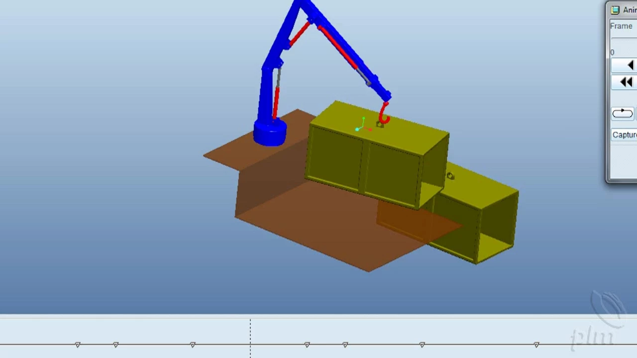

Animation using Snapshots
In this movie I've created an animation sequenci using snapshots, is not perfect yet but I've decided to show it up.

    Nice,  Animation.!!!
    Did you have to use ''body body locks'' in order to creates constraint between the containers and the crane?
    Aug 30, 2010 5:57 PM UTC
    Thank you Eric,
    In this animation I had to use "body-body", "plane-plane" and "point-point" constraints to achieve this results, but the way I've assembled the crane and the cargo have messed with their alignment while moving.
