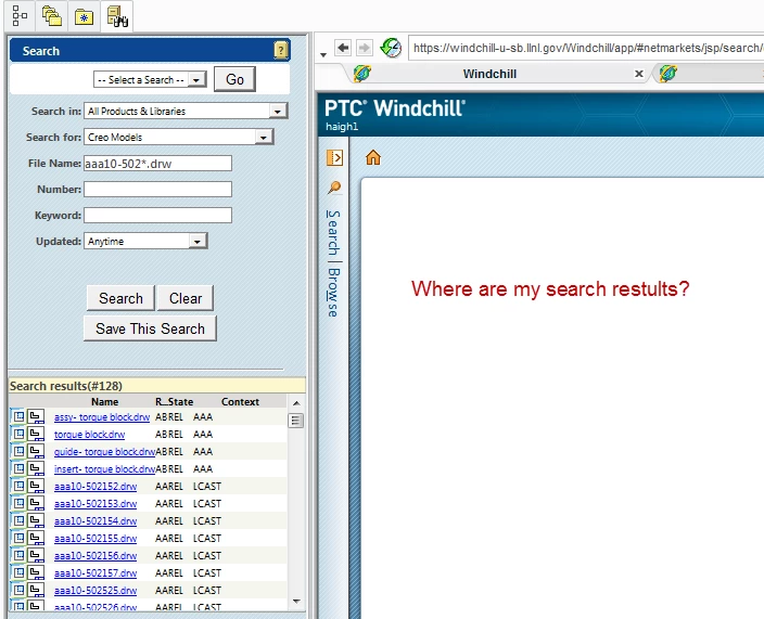

10.2 Creo Search Results???
In 9.1 you get results in the model tree area and also in the main screen. Where are my results in the main screen????

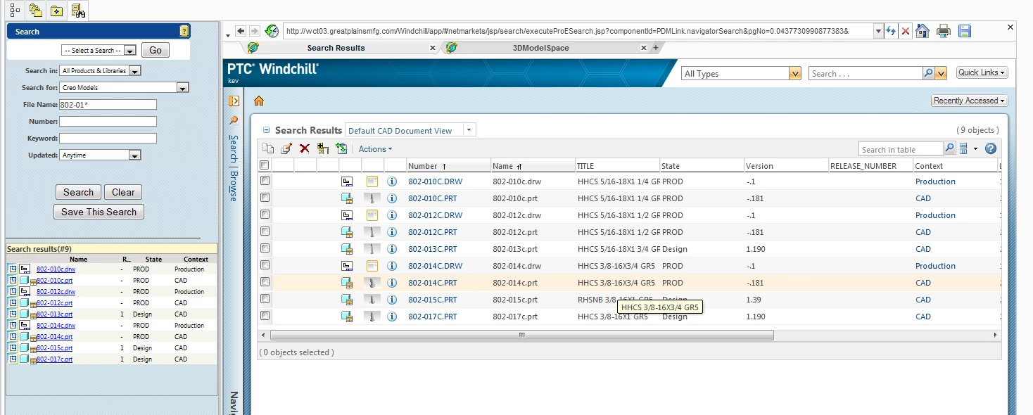

    I exited Creo, cleared the cache in IE9 and then started Creo again. The search shows up in both windows. Appears to work for multiple searches.
    However, when I went to the embedded browser to do a saved search, that worked but then the model tree search tab will no-longer update the embedded browser with the search results.

    In 9.1 the Creo search tab in the model tree area returned results in the model tree and in the main window. In 10.2, the results in the main window are not showing up. The window comes up but it's blank. What's up with that?
