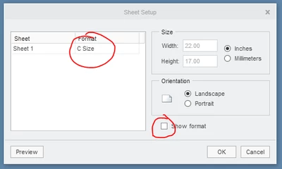

I know it's pretty late to answer this, but I had a similar Problem.
In my case solution was to set the frame to a default size and switch "show frame" to off. Than DXF was created with geometry only.
Maybe this helps other users with this problem.
