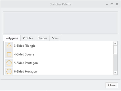

I set the 2d_palette_path in my config.pro to a location on Windchill (also tried desktop) and the path is not changing. The sketcher palette is still only showing the symbols located in the ptc directory\Common Files\text\sketcher_palette
this is an example of what i am putting in the config.pro
2d_palette_path C:\Users\username\Desktop
What am I missing? Why doesn't the path or symbols that are available changing as expected?

There are multiple options for palette, I don' know which one does what or if they are creo version specific.
For sketcher palette (which is what yours likes like) i'm on Creo 6.
sketcher_palette_path   is the option I use

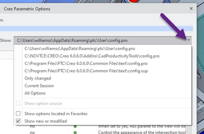

Another possibility is you have more than one config and the setting it overwritten before it ever takes effect.
Or it is set in the config.sup and is not changeable.
You can see which configs are loaded with the drop down arrow and review each.
Also, make sure you are using a full path
I'm out of other ideas.
