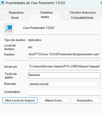

i already did a topic about this, but im still have the same problems
the path only works on the first try after i change it. But on the 2nd inicialization doesnt work anymore, i dont know what to do anymore.
maybe its something in my config
search_path_file $CREO_COMMON_FILES\ifx\parts\prolibrary\search.pro

What i did to make it permantly was reinstall the Creo, at least the start fold for the config  estabilized.

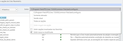

Is your system admin setting the working directory in the system config.pro or config.sys?
Open Creo, File-options and then Configuration Editor.
Look at the system loaded config.pro and config.sup files.

ACTUALLY i already lost the original config.pro of creo, because i put other config in the common files of creo.
when i open, i see this:
November 5, 2024
What is in that config.pro file?

I think you are expecting Creo to remember the last directory you were working in, that is NOT your "Start In" directory, and automatically go there the next time you open Creo?
Creo doesn't do this. It starts up with the working directory set to the Start In specified in the shortcut you use to start the program.
November 5, 2024
One option if you want to launch Creo from different folders is to put a shortcut to Creo in each folder and then launch it from there. I think this will set your working directory to that folder.
Also, if you double click a file in a Windows folder to open it, that will also make that folder your working directory.
