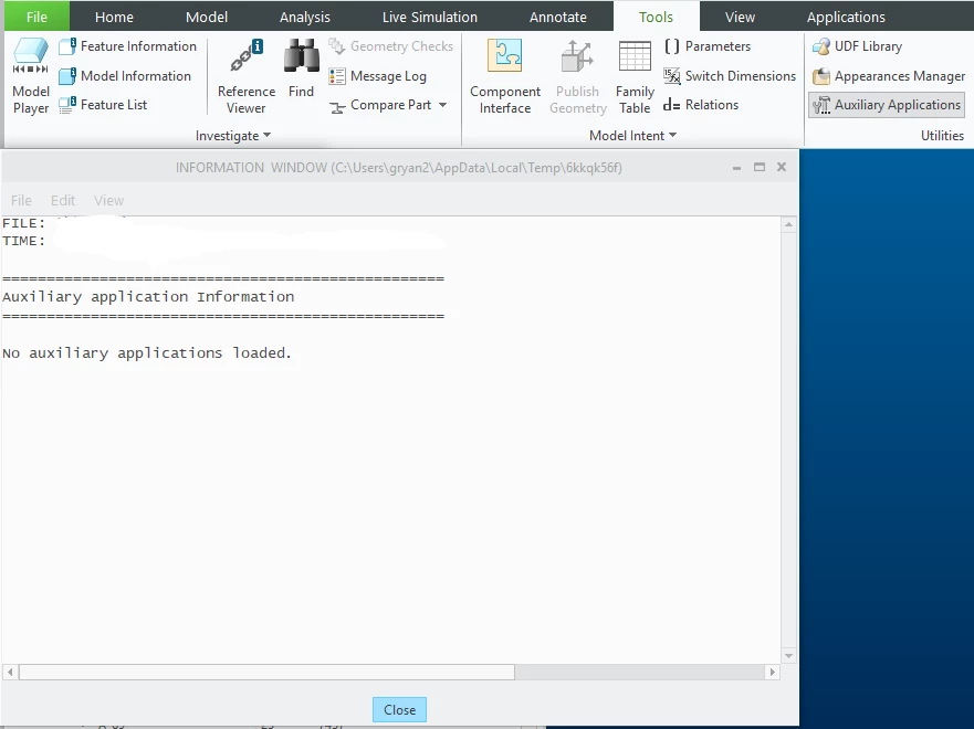

Looking around, I found mention of ensuring your drivers are up to date (they are) and that the Auxiliary Application is loaded in Creo. This information can be confirmed in the Tools tab, under Utilities, Auxiliary Applications, Information. It should be listed, but isn't, and I'm curious if I'm missing  a step to have my space mouse function properly again.

Try reinstalling the 3DXWare application (newest version). The install process should register it with Creo 7 as an aux application.
