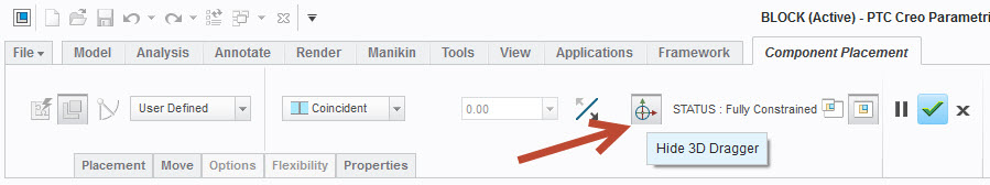

When assembling a component, there is an icon to toggle the 3d dragger on and off. It's only available when placing a component.
Image is from Creo 2, I'm assuming Creo 3 is similar.

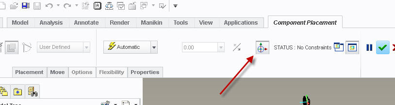

This is correct and the same is available in Creo 3.0:
