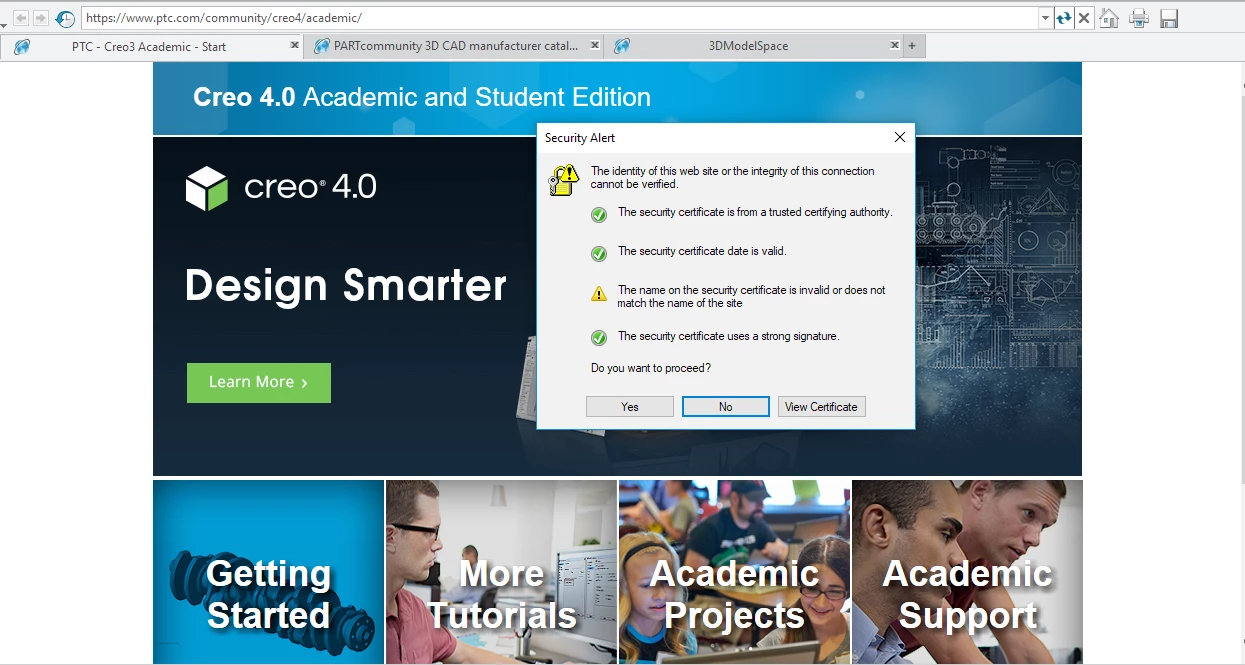

A alert message wen I run creo 4
  • August 29, 2018
  • 4 replies
  • 3343 views
Hi good afternoon, I´m using a educational license of PTC creo 4, when I run the  program I see these alert.
How can I solve it?
thanks for your time.
August 29, 2018
Click YES and ignore it.
6-Contributor
August 29, 2018
Yes, I do it, but whenever I run the program I see the alert.
So the question is if I can change any configuration in my system for avoid to see the alert
August 29, 2018
You can set a config option to change the default web page.
File > Options > Configuration Editor > Add > web_browser_homepage
Set it to some other website or just about:blank.
Save the change and the next time you open Creo this new page will load instead of the default one (with errors.)
