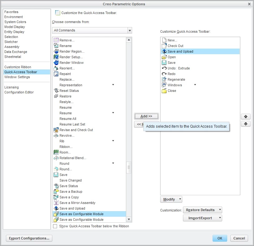

Am new to Creo Parametric 2.0 and trying to enable the PDM menus like server management, save and upload and checkin etc. Please let me know how these menus can be displayed. IS there a config option for this? Have been able to add them to the Quick access menu (image attached) but not in the regular Tools>server management or File>save menus.

As far as I know, under the file menu if you are connected to windchill, you get Check-in menu automatically which includes check in and check out. I have never tried to add them to another menu.
For upload, we use the config option: dm_upload_objects automatic
