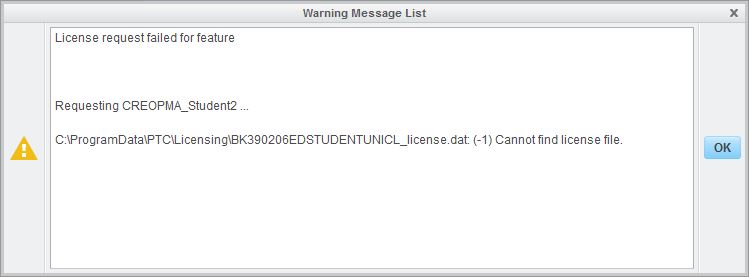

I am using a Mac and have just installed Windows 7 using Bootcamp (solely for CAD). I have downloaded and installed Creo Parametric for students but when I open it I receive an error about activation. I click OK and the application quits. Any ideas on what is going on? I have also installed Inventor with the student license and it is doing a very similar thing, in case that is relevant.
Here is a screenshot of the error I receive when launching parametric.

Creo Parametric cannot find license file mentioned in error message. Did you try to look into the directory mentioned in error message ?
I guess that you went to http://www.ptc.com/company/community/download page, clicked I am a College/University Student, entered requested info into displayed form and press Submit button.
Did you follow instructions from email you received after registration ?
