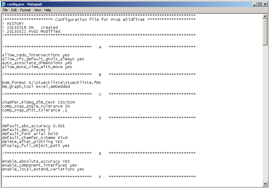

Hello all,
this should be simple - can't I prefix comment lines with the hash (#) symbol in the config.pro file?
Thought that was the way to do it, but recently noticed that the std.out file lists my comment lines as an error. The config file still works just fine though.
Andri

Try using an ( ! ) at the beginning of the lines you want to comment.

Hi Andri,
Bill Ryan is right - ! command is correct symbol for configuration file in ProE and Creo.
It is working for config.pro and config.sup file - see the example:

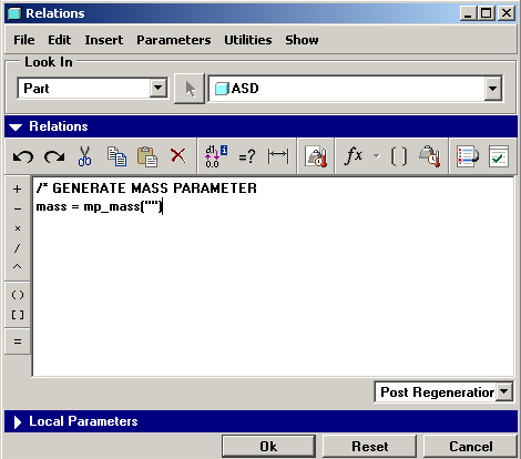

Note: for Relation comments you can use /* syntax:
