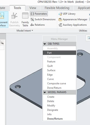

Aug 20, 2021 2:10 PM UTC
Hi Jose
I appreciate your mapkey which is very short and easy to modify for my own parameters,
however, after running it, the parameters display is no more a table but a menu... why ? how to fix that ?
Aug 20, 2021 2:39 PM UTC
The mapkey has to change the UI setting to menus in order to add parameters. He forgot to end the mapkey by resetting that value.
Check out the Update Parameters mapkey I added in this thread:
Re: Insert/Import Parameters to Existing Assembly - PTC Community

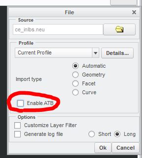

  1. Open your start part with the all parameters that you need.
  2. Save a copy as a neutral file (*.neu).
  3. Open a part that needs parameters added.
  4. Import the neutral file, the parameters come along with the import.
  5. Delete the import feature, the parameters will remain.
8-Gravel
Oct 20, 2016 8:06 PM UTC
I tried this method and all the parameters imported locked and un-editable.
Any thoughts as to why?
Oct 26, 2016 8:23 PM UTC
Make sure that you uncheck "Enable ATB" when importing:
