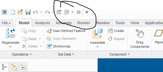

    I found the icon:
    Not what is the hot key to activate the icon?
    Thanks, Dale

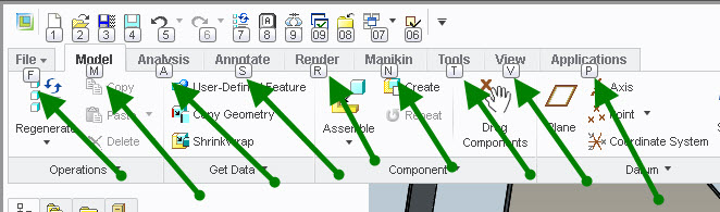

    Jul 22, 2015 1:58 PM UTC
    It's supposed to be like windows programs. So if you hit ALT-F, that's the file tab, then if you look at the drop downs or the icons, it shows a letter by each one indicating the key to get to that command.
    StephenW
    Jul 22, 2015 2:03 PM UTC
    This is the first level.
