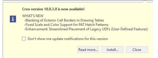

Alternative way to disable the pop-up message stating that a new version of Creo is available
The suggested techniques to disable the new version pop up to messages is problematic as I have users around the globe that have different .psf files for various reasons.  Manually going in and changing it for each user around the globe doesn't make much sense either.  Can there be a config.pro option to disable this functionality vs. modifying the .psf file or browsing to the General Setting dialog to disable.  I push a config.sup everytime the users launch Creo from a globally common location so that is the most desirable way to turn off this functionality.  So there is no confusion, an image of the message I want to disable is attached.

You can set the environment variable
CREO_MOR_NOTIFY_DISABLE = true
We do this in our startup script.
More info here:
https://www.ptc.com/en/support/article/CS329749?source=search

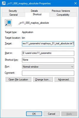

if you disable unwanted functionality by browsing to the General Setting dialog then this action is recorded into trail file (I hope).
Later you can use this trail (little bit modified) when you start Creo.
For example ... in my case Target field contains
"E:\PTC\Creo11_000\Creo 11.0.0.0\Parametric\bin\parametric.exe" "E:\users\creo11_parametric\mapkeys_01_trail_absolute.txt"
Appreciate the information Martin!  I'll ponder this approach.

Thanks Chris!  I can push new start scripts to add that environment variable.  In our current IT world, it is difficult to push scripts globally which is why I was hoping it could just be in a global config that I push.  It is the only thing I push that is common to all locations.  Again, appreciate the suggestion!
