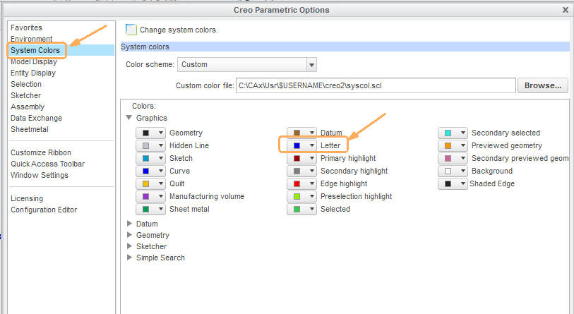

Anyone have any idea how to change the color of annotation features in Creo. My company just switched to Creo from Wildfire 4 and I am partially color blind. The default scheme doesn't agree with my eyes very well. Thanks.

    I have a color table set to closely mimic the old Pro|E interface. Someone may have one that matches the WF interface. Technically, you can reset pretty much all the colors through a syscolor.scl system color file that is called up in config.pro.
    system_colors_file <drive>:\<path>\<sys-color-file>.scl

    i think it is the "Letter" color in the Colors>Graphics.
    The color settings are confusing. It was a game of wack-a-mole to figure out what controls what, confusing because the description of what color you are setting isn't consistent.

    As Ryan points out, the color is driven by the 'Letter' setting.Letter_color.jpg

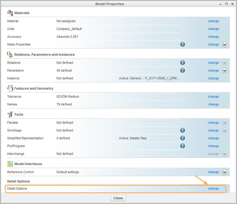

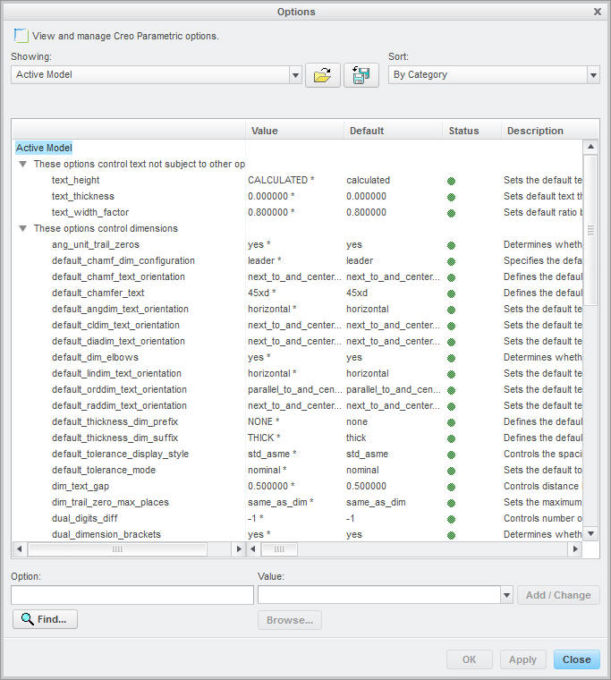

    All other 'drawing setup' options for the 2D elements in 3D models in Creo1 or 2 the are managed within the part, such as text hight, tol display and many more.
    That means if you want to have it permanently changed you must implement it in your start part.
    It is to be found and modified here:Model_Properties.jpg

    Constantin, I am actually referring to Creo 2.0 and am specifically referring to various annotations as they are viewed in part modeling mode.
    For instance, when you display a coordinate system on a part, what color setting needs to be adjusted to change the color of the 'X, Y, Z' on each of the 3 axes? I have tried adjusting the 'Letter' setting but this isn't it. I've also adjusted the color of the 'tag' for the coordinate system (and tags for other datum features) but this only controls the color of the name label for the coordinate system.
    Take a look at the image below to see what I'm trying to adjust.
