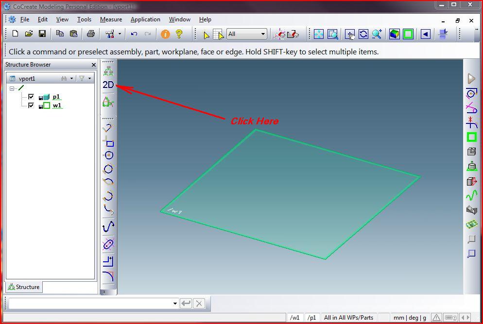

Annotation no longer starts up by default. Click the 2D Icon on the left side of the viewport to start it.

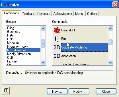

Hint: If you are in Annotation you might add a button in one of your toolbars called "3D" (CoCreate Modeling) to return with a simple mouse click to the 3D part. "Tools -- Customize - Groups - Misc ... scroll down to the 3D button and add this to an exisitng toolbar. then you can use this toolbar icon or the icon in the lower right corner (arrows) to move between Modeling and Annotation.
