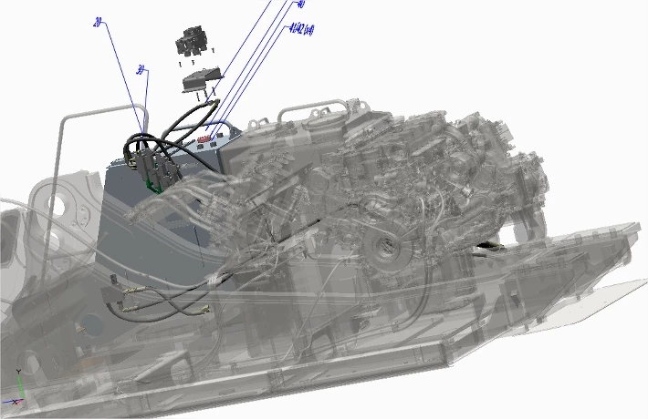

This is not possible to keep annotations linked on the component to their exploded position during a conversion.

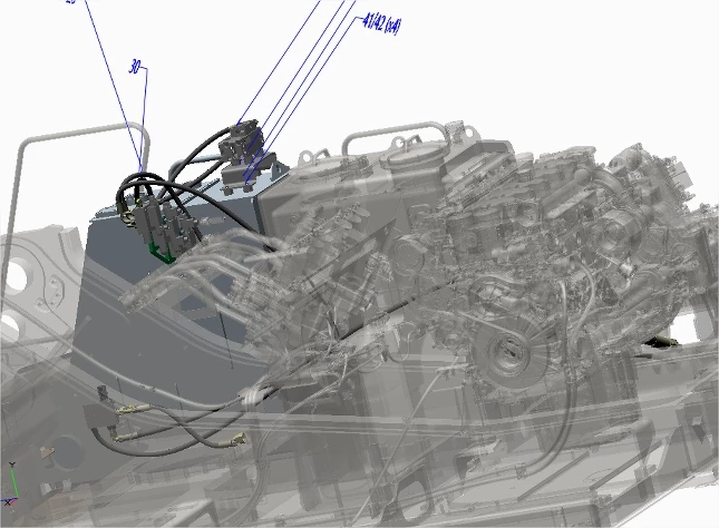

    Hello, yes it works in Proe. Not in CreoView after creation of the viewable.

    So if I understand correct. You have the tags placed properly in the exploded view and then export (convert) it to CreoView. Upon opening the CreoView file, the tags are not in the proper place?
    Sounds like a bug that needs to be reported.
