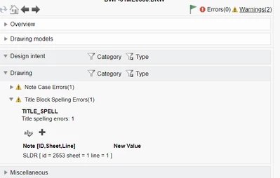

August 21, 2023
There is a user_words file that your company can add words to that fit your industry.
Very easy to edit and add your own words.
I capture all ModelCheck reports in a folder and review them periodically and add words to our file when I find them flagged by ModelCheck.
B_Baker12-AmethystAuthor
August 21, 2023
I have a user dictionary with 845 words and adding to it daily.  Some of the thing that need to be added, I would think should already be in the standard PTC  library.
I like the idea of running the reposts to look for spelling.  It would make the users happy.
