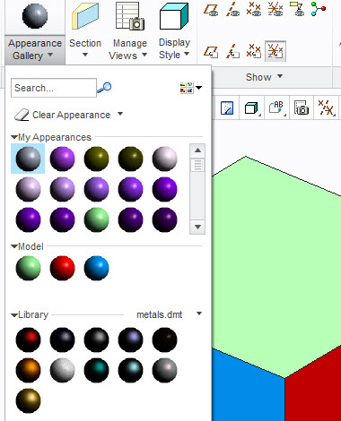

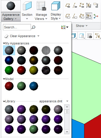

In Creo 2 there is much more ambient light displayed on the balls and hi-lites are clearly displayed.
This is what it looks like in Creo 2.
This is what I see in Creo 3. The only improvement is I now see one of the colors is transparent.

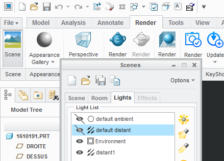

Hi
I have solved similar issue ( CS151783 Helping me )
Edit default scene and disable default distant light. ( save and replace the scene )
Restart Creo and look at the appearance gallery

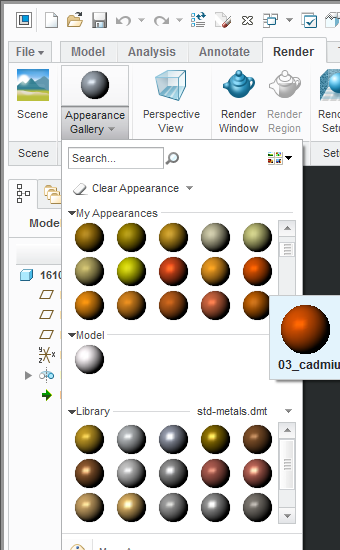

This still isn't even close to what level of realism we had with Creo 2.0. If you look at your screen shot showing "Library   std-metals.dmt" color choices, you can see that the metals shown still are not very realistic as they were previously. It's very difficult to tell the difference between many of these choices.
Until now, we relied heavily on these appearances for metals. Now we cannot any longer. This is not acceptable. Especially in light of the amount we pay for support.
