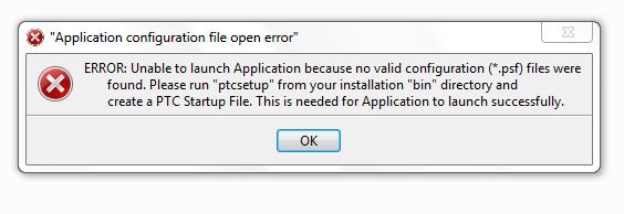

Application configuration file open error
Hi all.what causes this error and how it can be removed.i get this error when i want to load Cro Parametric.

    I suspect your startup shortcut if incorrect. Do you still have the default Creo startup shortcut and does this function? Has anyone changed folder names or locations for the Creo install? Do you have multiple Creo installations? Is the path pointing to non-existing "earlier" installation?
    I will suggest you start a case with PTC to confirm the install if you still have maintenance.

    I have been having the same problem and am dead in the water.
    We just upgraded to Creo 2.0 and cannot get it to open.
    Application configuration file open error,
    unable to launch application because no valid configuration (*.psf). etc, etc, etc,
    Uninstalled everything that is PTC related, and re-installed manually to no avail.
    It appears that Creo cannot find the parametric.psf that does exist in the parametric\bin folder.
    Or there is something incorrect in the parametric.psf file itself.

    I'm going to take a wild guess here but I will recommend you open a support case and have customer support walk through this with you.
    My guess is that the PST file is the personal preferences file that exists somewhere in the user folders (not PTC folders). I know that as you upgrade, your personal settings are maintained. This is primarily the ribbon modifications. I don't know exactly where they are located, but you might need to remove this folder before installation of the application.
