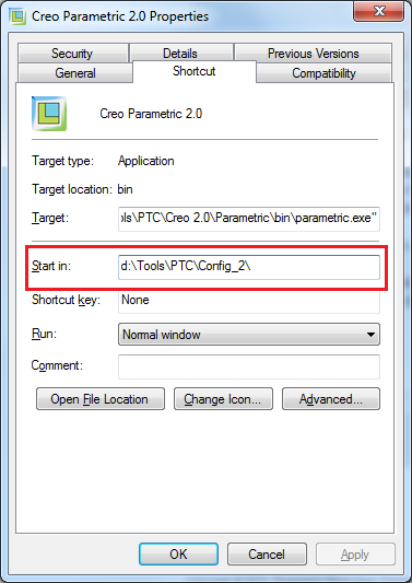

3. To add options to config.pro you simply go (in Creo Parametric) into File > Options > Configuration Editor, then click Add button and enter the name and desired value for option. In Creo Elements Pro it's Tools > Options. You can also directly edit config.pro file, since it's simple text file and put new options in there, it should look like this:
option_name [space] option_value (option names and values have underscore and are separated by space)
Your default config.pro files should be either in your user's documents or it's in the location defined in Creo Parametric (and Elements Pro 5.0) shortcut properties "Start in" field.
So you can simply copy&paste config.pro options I gave you into your config.pro file, save it and run Creo. Remember, that you need to put correct options for both Parametric and Elements Pro, and then save model in Parametric to be able to open it in Creo Elements Pro.
