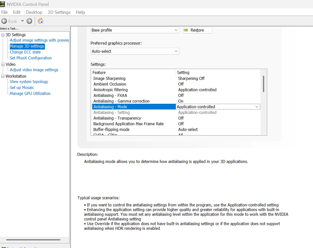

20-Turquoise
April 11, 2025
Make sure his/her Nvidia Antialiasing Mode is set to Application-controlled. We just switched to Creo Parametric 11.0 and had a couple of users with the back screen in the graphics area issue. It turns out they had the Antialiasing Mode Setting not set to this and had the Antialiasing - Setting set to some value. Setting their config.pro option enable_fsaa off worked also but "fixing" the Nvidia Antialiasing Mode by setting it to Application-controlled seemed the better solution, in our case.
