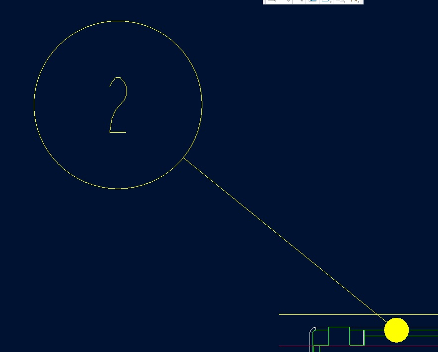

i want to change baloon style? it is posible ? be a parameter name in config .pro?
the point is too bigger how i scale or minimize
be in creo a scalling factor for this point?
tks
dcox-2Answer
May 13, 2015 9:25 AM UTC
There are a couple of variables in File→Prepare→Drawing Properties→Detail Options that should help you.
Under "These options control leaders", draw_dot_diameter will let you change the size of the filled dot.
Under "These options control tables, repeat regions and BOM balloons", def_bom_balloons_edge_att_sym lets you change the dot to another shape if you want.
Under "Miscellaneous options", max_balloon_radius and min_balloon_radius allow you to change the size of the balloon.
