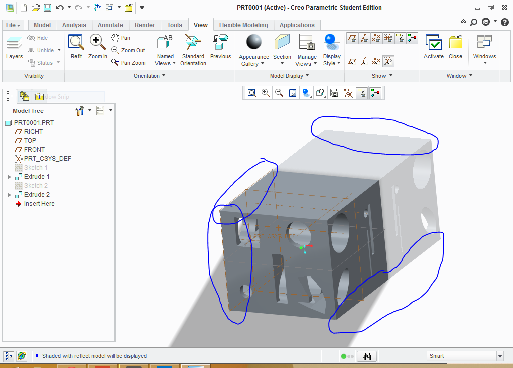

Hi I am using Creo Parametric 2.0 Student's edition.
My rig is an i5 3.1 GHz with 8 gb RAM and an NVIDIA GTX 660 2 GB GDDR5 graphics card. When I try to create simple parts in creo parametric, their edges appear a tad distorted. How do I fix this to get smoother edges? I have tried using the NVIDIA control panel and changing the settings specifically for creo parametric, but the difference was negligible. Please help as soon as possible.

try this:
shade_quality 10
enable_fsaa 16
edge_display_quality very_high
note:
your performance will be decreased when this settings are applied!
Greetings Sam

go to file > options>model display> shade quality to maximum. check the other options too.

smooth_lines yes

thank you so much
