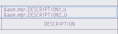

In my model I have two parameters that read : DESCRIPTION_LINE_1 and DESCRIPTION_LINE_2. These two lines show on my drawing title block as two lines of text if the description of the part is too long to fit on a single line.
Is there any way to combine these two parameters so that in my BOM on an assembly drawings both lines of the description appear?
Currently I am only getting the first line of the description based on the report parameter asm.mbr.description_line_1

Mar 16, 2023 2:40 PM UTC
You add them both together like the following:
&asm.mbr.description_line_1&asm.mbr.description_line_2
We use something similar in our Description column.

Mar 16, 2023 4:10 PM UTC
My method just puts 2 lines in the one cell, no concatenation of the 2 description parameters.

Mar 16, 2023 2:45 PM UTC
We do this in the parts/assemblies with a relation and in our bom table we use &asm.mbr.DESCRIPTION
DESCRIPTION = DESCRIPTION1 + " " + DESCRIPTION2 + " " +DESCRIPTION3
I suppose you could do that in a repeat region relation if you don't want the relation in the part and refer to it using the &rpt.rel.description
Mar 16, 2023 3:01 PM UTC
You can also put both lines in the BOM format cell.
(different formats, but same principle)
We use a slightly smaller font (.140 instead of .156) on D & E formats, but still readable.
