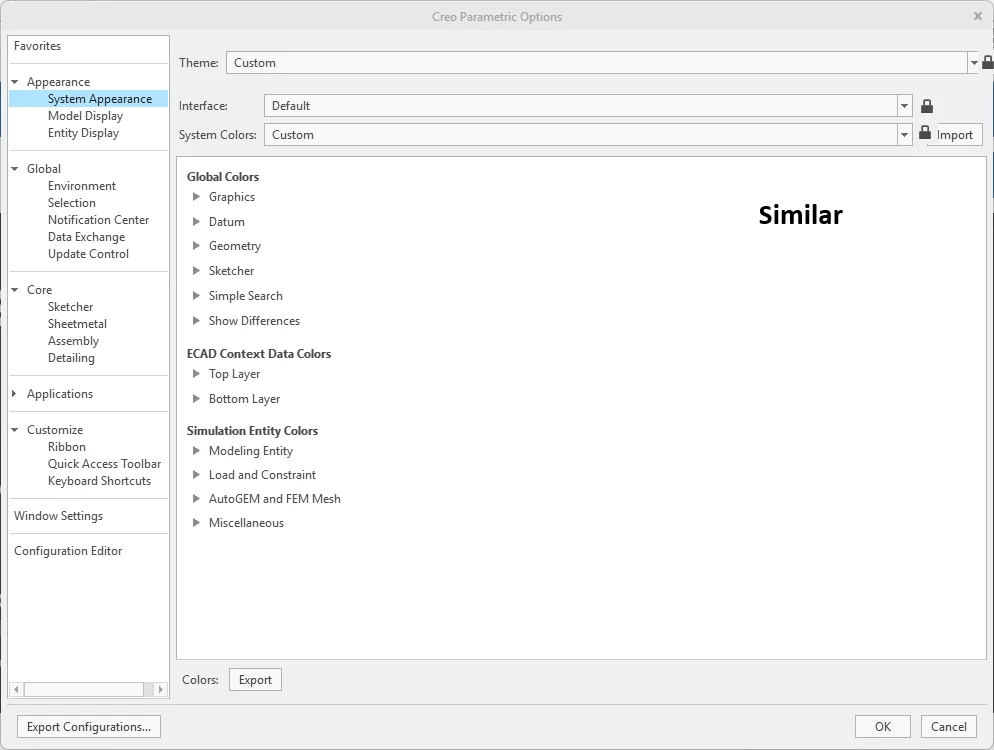

Is it possible to block the System colors, Interface and Theme options in Creo Parametric (10.0.6) from unauthorized user changes through config.sup?

Yes, it is already blocked in Confi.sup, but these options in question are not blocked.
Responding to your curiosity, my intention is to standardize all stations that use Creo. In the case of color blindness, I can later create a Mapkey to change the color system temporarily.
colors mentioned on Block-Colors-2025-07-02.png picture are saved in creo_parametric_customization.ui file. AFAIK administrator cannot block them.

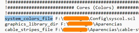

I think unlikely.
Have you tried adding a system_colors_file to the config.sup to see if it locks those settings?
