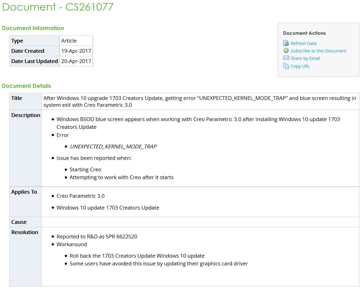

April 21, 2017
PTC Solution - roll back Windows 10 Update.

April 24, 2017
A TS Bulletin has been posted on the PTC Support Website:
Windows 10 Creators Update (1703) may cause blue screen system shut down with Creo Parametric 3.0
Amit
mphilipp1-VisitorAuthor
April 26, 2017
What is it saying? I dont have permissions to see it. Is there an update coming soon? Hope so, having exam in 2 months and working on school pc is cancer
