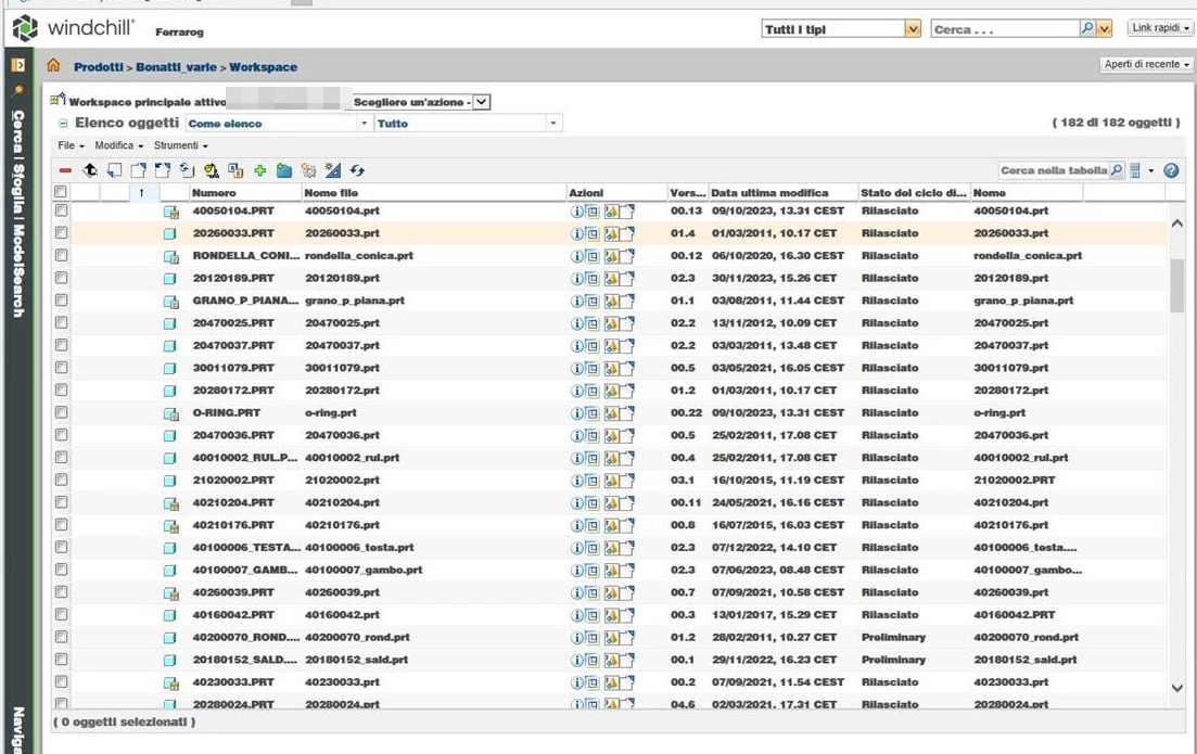

Bold font in embedded browser
I am using Creo Parametric Release 8.0 and Datecode8.0.2.0
Since a couple of week tthe font displayed in the embedded browser window appears in bold format and I can't set it to normal.
