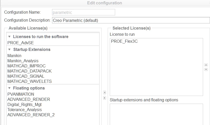

I've just been testing this on a VM not a real laptop, but I think it should perform the same. I'm confused.
I ran C:\ptc\Creo 2.0\Simulate\bin\simulate_borrow.bat.
I borrowed the license for 1 day, and then I looked at ptcstatus:
PROE_AdvSE 3 7
^(dave@xxxxx) PROE_AdvSE
PROE_Flex3C 2 18
(duffy@xxxxxx) PROE_Flex3C
(santos@xxxxxxx) PROE_Flex3C
(designers@) PROE_Flex3C
MECBASICENG_License 0 22
MECBASICUI_License 0 22
This shows that I borrowed the Creo Parametric License PROE_AdvSE, But MECBASICENG & MECBASICUI show no licenses borrowed.
Shouldn't I see one of them borrowed. Also how do I borrow a parametric, simulate and mathcad license at the same time?
When I configure licenses, I don't see a way to add simulate to a license configuration I would pick when I borrow the license.
