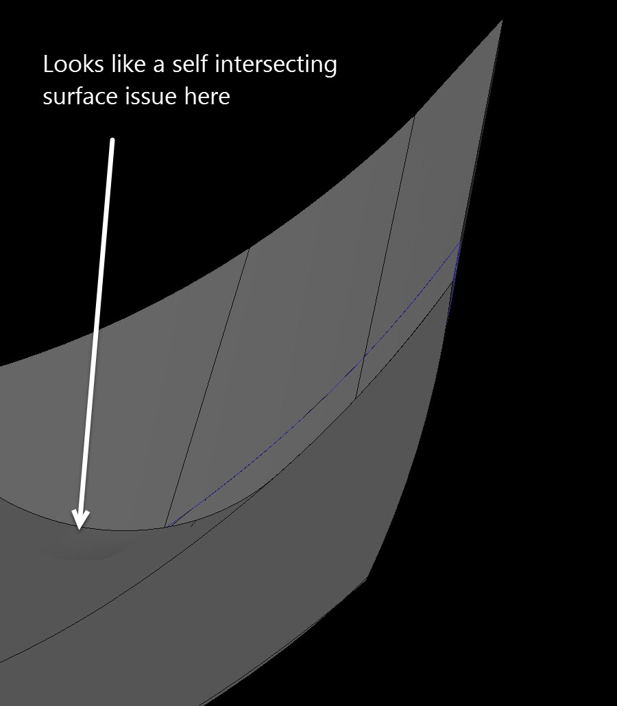

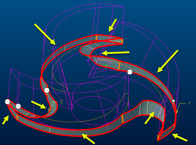

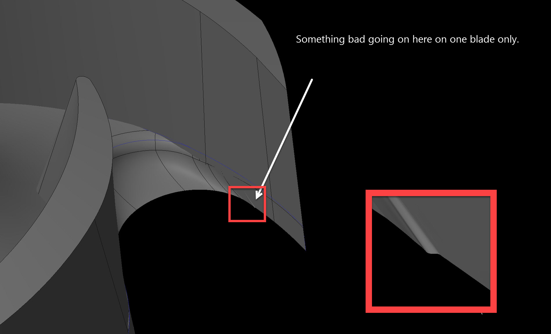

Attached is another impeller I'm working on. Went well until the final merge where the walls of the boundary blend bulge out and it fails on single edges. I've fiddled with the BB settings but no luck, any ideas?

Your problem is with your short curves in your second direction. They don't line up well.  I eliminated them from the blend and used control points to make the surface.  I trimmed the bottoms of the 3 veins away with a revolved cut. and then merged the boundary blend with your revolved / removed surface.  Note this is still not optimal as your vein surfaces are not continuous with that blended part.  There are things now that really mess with making the rounds you may want.  I will see if I can fix it how you want.

I think the issue is the amount of curvature incorporated into the problem surface.  I would recommend separating this into multiple surfaces then merging them together instead of trying to create this as a single entity.  I'd break this down into as many as 9 separate boundary blends in order to maintain control over the surface shape in each area

Odd that it only occurs in one area!

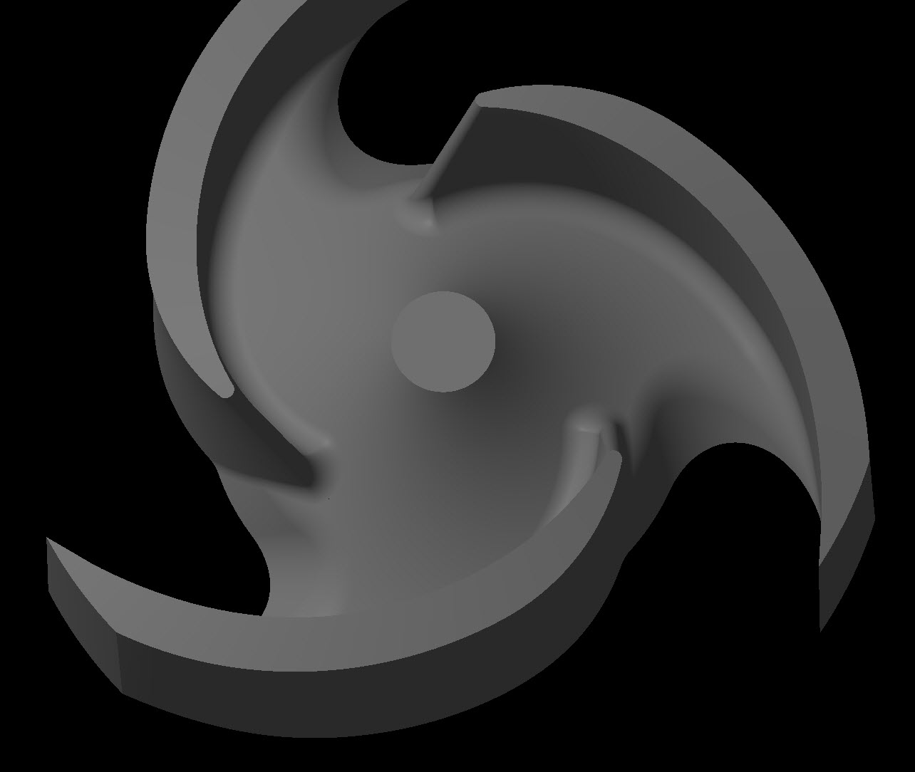

There are many ways to do this.  Your biggest problem is making sure you are using the geometry you have already created.  Your boundary blend was like an add on and things were not lined up.  Here is one I played with.  I used draft and a surf to surf radius to approximate what I think you are trying to create.  I would need more information from you on what is important and what are you trying to achieve before I could offer any other information.  Attached is this last file I created.imp3.jpg

Many thanks for your help, I've played with the model some more and managed to clear the errors. But now it won't solidify!
Attached is the final shape the impeller should be.

Your problem is coming from too many in accuracies you have built into your controlling geometry.   You really need to step back and rework all of your control curves.  Edges need to be tangent and items need to be joined together.  imp5.jpg
