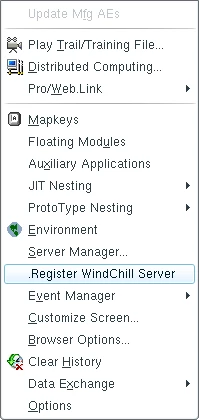

Can a Windchill server be registered before launching Pro/E?
Later this year, we will deploy Windchill for the first time. (currently using Intralink 3.4)
When users launch Pro/E, they will need to register the one-and-only Windchill server.
I would like to automate this in our launch script.
For example, can I specify the server in config.pro?
Or set an environment variable?
Other?

I have created a mapkey that properly enters the correct information. Then added
that mapkey called ".Register Windchill Server" to the Tools menu immediately
following the "Server Manager". See attached screenshot.
The mapkey guarantee's the server's name and location will be correct. If name
is not correct then your config.pro options, that point to the Windchil server,
such as pro_format_dir will work. Not to mention if the user enters the wrong
location the registration will not work.

I understand that it is indeed a set-once occurrence.
Unfortunately, I have a considerable number of "unsophisticated" users who will ignore the instructions or fail to follow them correctly.
I am hoping to avoid a bunch of unnecessary helpdesk calls.

Gerry,
It is possible to do what you are after.
Here's an explanation of how you can pull this off.
Create a trail file, we'll call it gerryTrail.txt, that registers the
PDMLink sever.
Tool > Registry > Server > Register New Server... > Enter Server Name and
Location > Check...
Trail file ends at after selecting Check... button
Place the trail file in a location the users can access it. I suggest
copying it to their machine when your startup script is run.
If the user has registered to PDMLink they will have a file in
%PTC_WF_ROOT%\.Setting\config.fld
If the user has not registered they won't.
This is how you will determine a no-registered users
In your startup script have two line to start proe one for registered
users and one for non-registered users.
Something like this
rem ProE startuo for registered users
if exist %PTC_WF_ROOT%\.Setting\config.fld call
%PROE_LOADPOINT%\bin\proe1.bat
rem ProE startup for non- registered users - run trail file to register
upon startup
if not exist %PTC_WF_ROOT%\.Setting\config.fld call
%PROE_LOADPOINT%\bin\proe1.bat <full path=" to=" trail=" file=">\gerryTrail.txt
Note the trail filename must have the proe iteration number removed.
When an unregistered user starts proe they will automatically be presented
the authentication window where they can enter their username and
password.
FYI, this is just one way to do it. There are other but this is probably
the most straight forward way.
Hope this helps.
