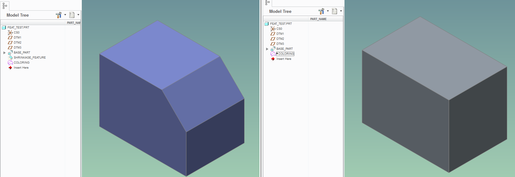

November 2, 2016
I've never used the mold extension, so I don't know what the shrinkage feature looks like in the model tree.
But I'm thinking that it includes some feature parameters.  If that's the case, then maybe you can do something with Pro/Program, like in this attached example:
Here, I made a feature (the chamfer) that I called "SHRINKAGE_FEATURE".  I added to this feature a parameter called "SHRINKAGE_FACTOR".
Then, in the Pro/Program, in the part of the code that adds the feature "COLORING" (which is just a copy of all solid surfaces of the model), I have the condition that this feature is only added if the SHRINKAGE_FACTOR parameter exists with the feature called "SHRINKAGE_FEATURE".
Check out the included part and its pro/program code and observe that if you rename or delete the chamfer, then the part changes back to its original color.
Obviously this hack might not serve your needs.  One thing about it is that you can suppress the "shrinkage", er, the chamfer and the coloring will remain - it seems that the parameter still "exists" even if the feature is suppressed.  There is also the housekeeping headache of keeping that COLORING feature at the end of the tree (is that even possible, or does the the shrinkage feature insist on being the last one in the tree, similar to flat-pattern in sheet-metal mode?)
But, I'd be really interested to know from Pro/Program gurus - is there a way to know whether a feature is present or suppressed in Pro/Program?
