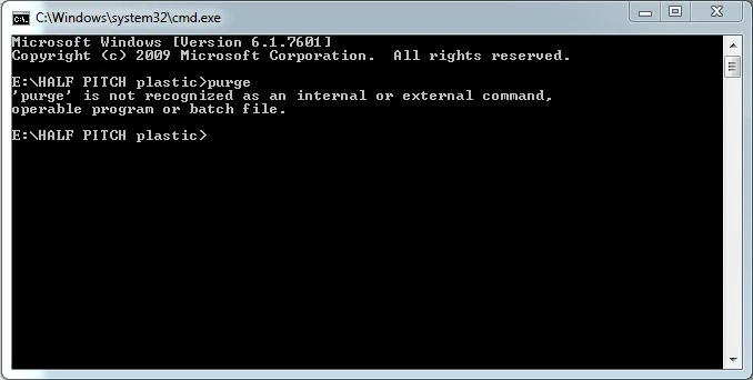

Can't able to purge
Hi
i can't able to purge the working directory, hereby i aslo attached the screen shot of the error. whats the problem with me
can any help me. am using creo 2.0
Vinoth

Vinoth,
you have to modify environment variable PATH and add a path similar to the following one at the end of definition:
C:\PTC\Creo 2.0\Parametric\bin

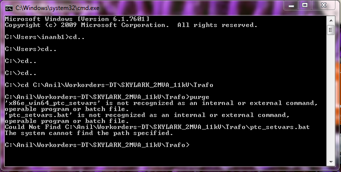

Jul 18, 2013 8:45 AM UTC
Hi
Do you need to set system Environment Variable = PATH to your purge.bat file
for example: d:\ptc\proeWF4\bin\
Vladimir
Jul 18, 2013 8:58 AM UTC
Dear Vladimir,
i already set path by seeing the previous comments, eventhough i am not able to purge.... its creating the big problem please provide me solution.......the same error posted above is appearing i can't understand the source of error

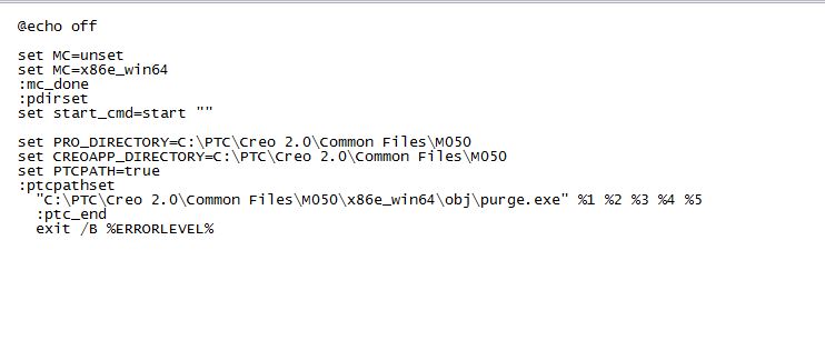

This purge issue is seeming to get worse, while I am aware of the global variable setting for the PATH to the PURGE.BAT I have recently found that even that is not working, as I have just had a reinstall of my system 4 weeks ago after window update corrupt the OS, I also installed M050 at the same time, and I couldn't get the PURGE command to work.
So, I decided to find a simpler solution.
I made a copy of the origninal PURGE.BAT file
Then I edited the PURGE.BAT as follows
This is now my purge.bat file.
The main line is the 3rd from the bottom, it is the location of the purge.exe file.
And the the SET MC= command at the top is the system version installed " hint" it is in the path statement for the location PURGE.EXE
It appears that most of the purpose of the Purge.bat is to establish the path location to call the PURGE.EXE.
So I just made it simple and told it exactly where to look without the need to go to global variables, as our IT dept, is really craking down with restriction on what we can run and edit.
This solution has worked for me, and at this momnet I haven't seen any side effects.
Always remember, when you are experimenting, alway back up the files first, so you can undo it, if you make a mistake.
just some ideas for comment.
Peter
