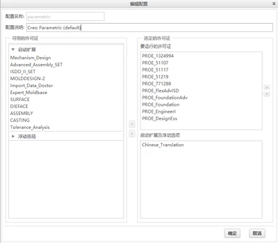

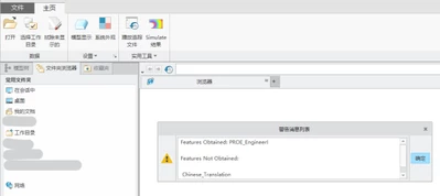

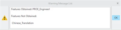

Hi Partners,
I want to run Creo Parametric in Chenese simplified.  (Creo Parametric 4.0 M020),
  1. I have the license available and added it when I installed it.

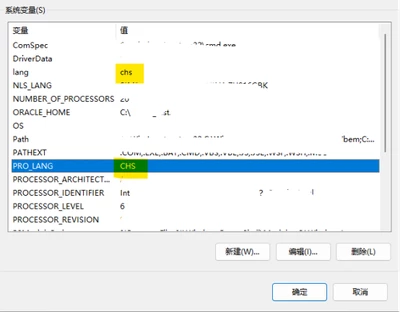

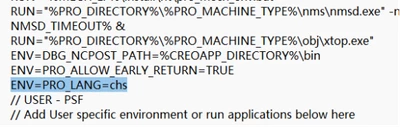

  2. I have added "ENV=PRO_LANG=chs" to the end of the .psf file and set the LANG and PRO_LANG environment variables.
  3. Modified the following options
dialog_translation yes
help_translation yes
msg_translation yes
menu_translation both
enable_popup_help yes
button_name_in_help yes
 It can't be helped.☹️
It works in the simulate module , even though the prompt window still pops up.😫
Any idea? Thanks.
