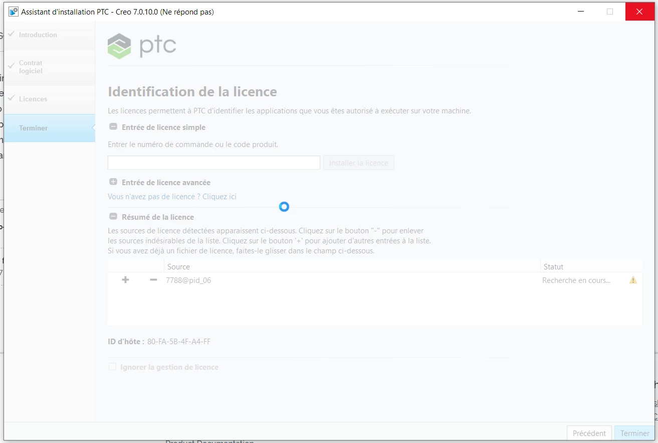

I'm currently working on Creo3.

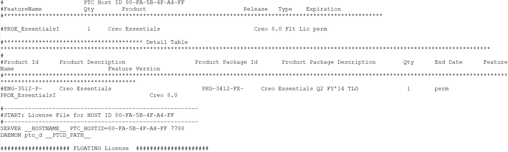

I have a licence file for Creo7 (permanent) that I need for a new client.
I d'ont have subscription anymore.
When I'm trying to add this licence file (txt) while installing Creo7, installer seems to freeze.
File is for my computer.
Should I remove my previous licence ?
But I'm afraid to can not be able to work...

Q1: Is Creo7 license locked or floating ?
Q2: What network card is mentioned in Creo7 license ?
It's seems to be floating licence.
But I'm triyng to install licence server and Creo client ont the same computer.

OK the license is floating.
Q1: What network card has assigned MAC address MartinHanak_0-1763731842041.png?
Please run ipconfig /all  in Command prompt and publish the output.
Q2: Is it Ethernet, Wifi, USB card?
Q3: Is Flexnet already installed on your PC?
