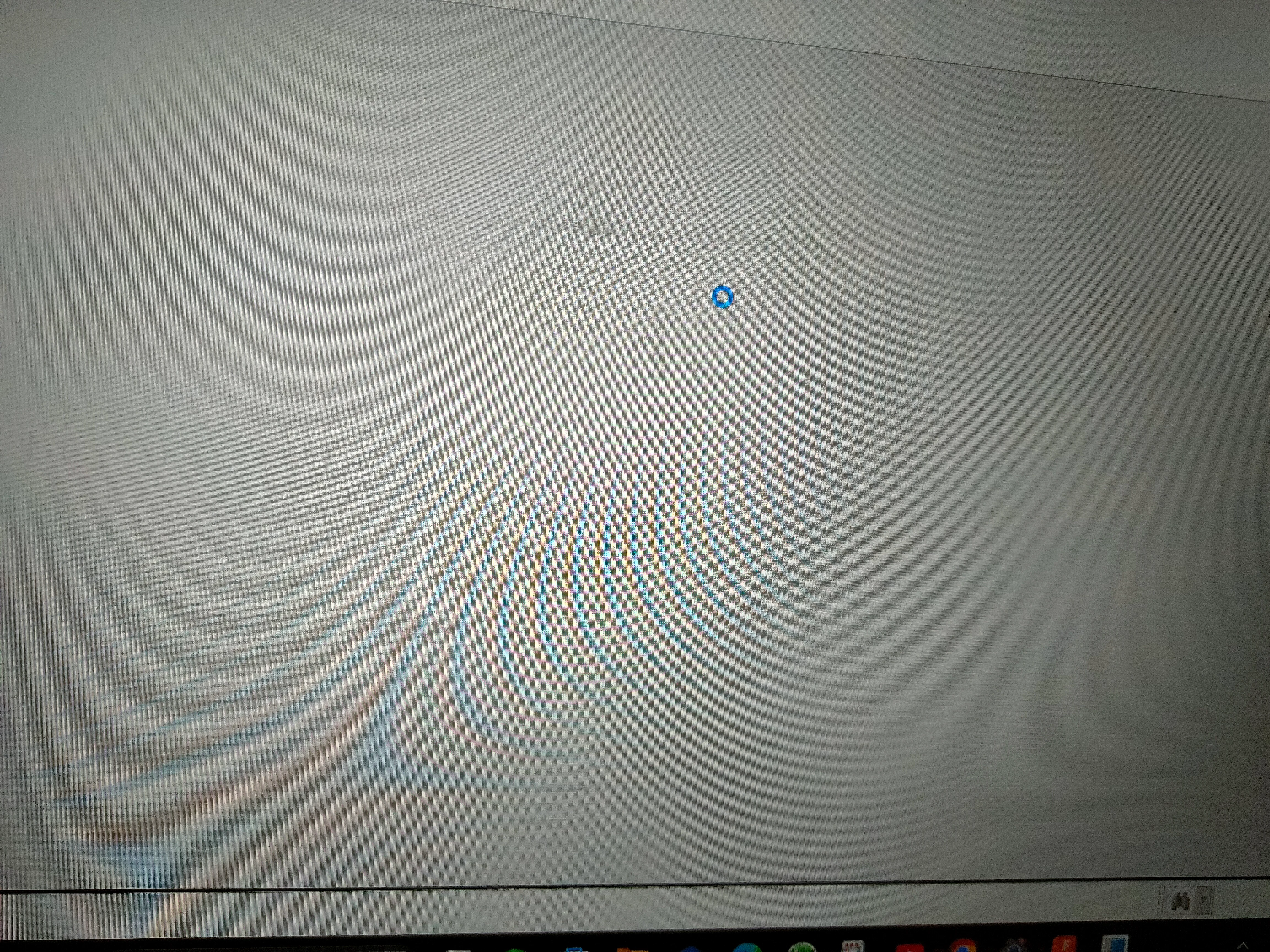

I installed creo 10 some days ago and did some designs in that. later again I moved to creo 9, but after installing that I can't able to open the designs that I did in creo 10. Ps : I am using student version. please comment for any solutions ! When I open only I can see blank screen as shown in picture I attached.
you cannot use Creo 10.0 files in Creo 9.0. You have to re-create them in Creo 9.0.
Creo files are not backward compatible.
