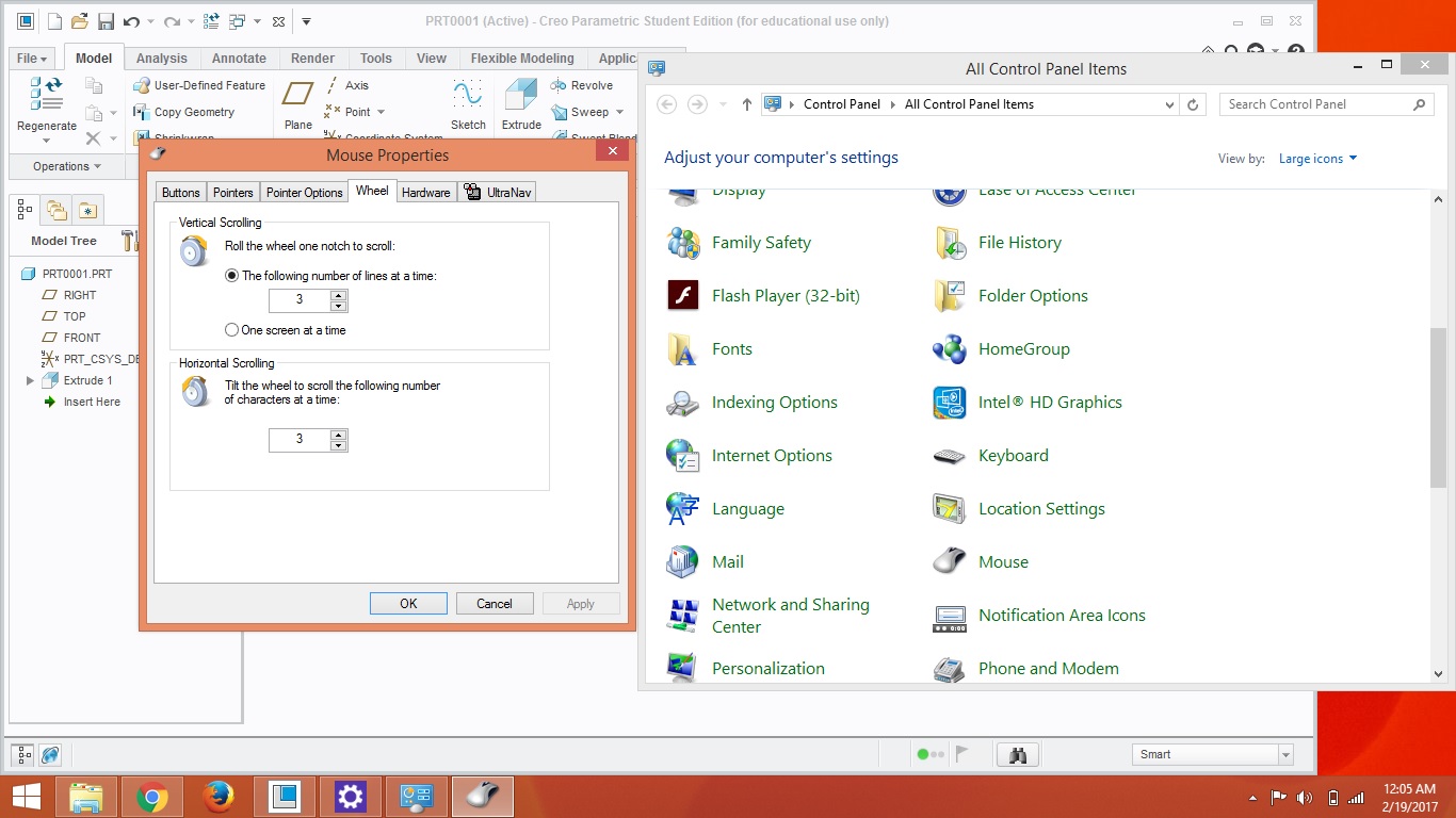

I cannot rotate the object in creo 3.0 parametric on windows 8 on my lenovo think pad. i am using logitech wireless mouse with scroll.
tried all possible solutions mentioned but cant solve my problem
this is the window in creo, trying to rotate the object using scroll
tried editing mouse settings but every thing is right in that
tried editing mouse settings but every thing is right in that.
please provide me with the solution.
note-by using scroll i can only zoom in and out but cannot rotate object.

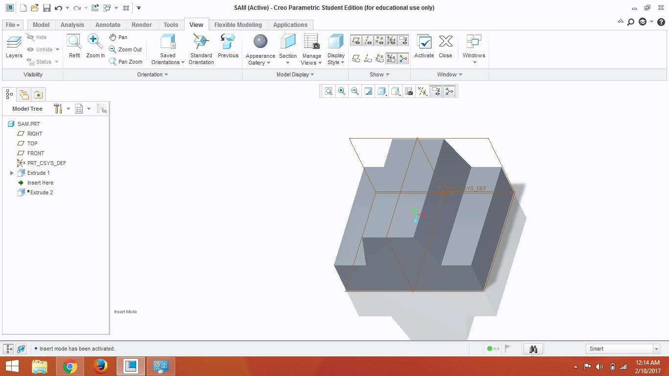

Also tried various viewing options but wile drawing and excruding i just cant rotate with the scroll .please help.

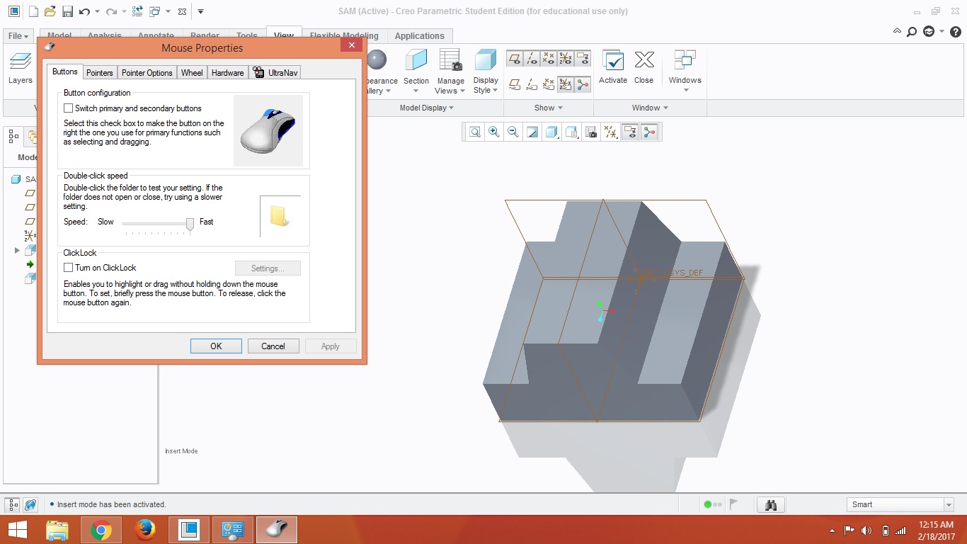

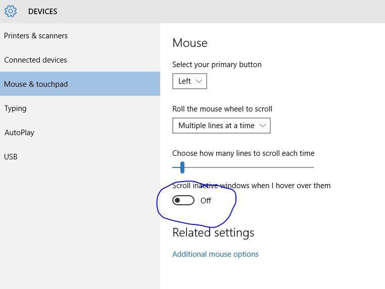

Make sure your middle mouse button is set to MIDDLE CLICK specifically.
sdube1-VisitorAuthor
February 18, 2017
hi
thanks for your reply
but there is no such option available please have a look to the screen shot
StephenW
February 21, 2017
You may need to install a mouse driver to customize the button. Looks like the windows driver doesn't give you the option anymore.
February 18, 2017
I hope Middle button setting can be done on Wheel tab in Mouse Properties dialog box. You have to press  &hold Middle mouse button to rotate.
