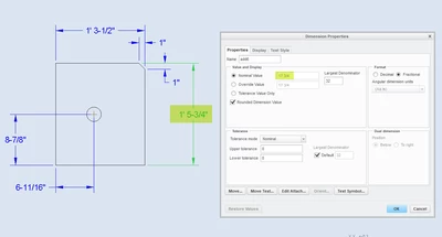

Cannot get fractional dims to show in just inches, not feet-inches, see below.
I am using Creo Parametric Release 3.0 and DatecodeM050
I am trying to show fractional dimensions in inches, not feet-inches. For example, 1' 5-3/4" = 17-3/4".
I have tried changing config-pro and I can't seem to find the right option.
In the Dimension Properties window, the Nominal Value shows just inches. Why doesn't it show up that way on the drawing?
Is there a way I can get it to?

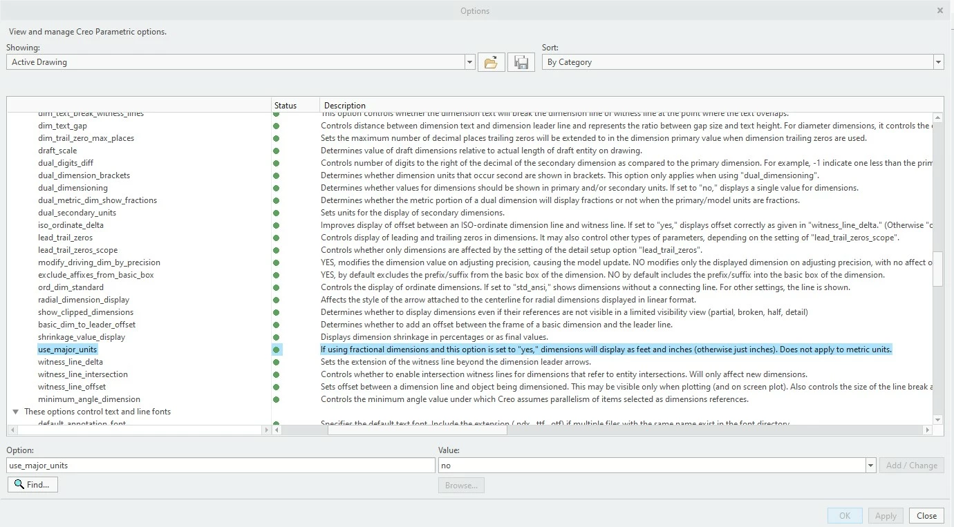

File/Prepare/Drawing Properties
In the dialog box, select 'change' next to Detail Options.
Select 'find' and search for use_major_units.
This should be set to 'no'

With the drawing open,In the drawing setup files under
file - prepare - drawing properties - detail options change
verify use_major_units NO
In the config.pro, verify use_major_units NO
open the model that the drawing refers to
under file - prepare- model properties-detail options -change
