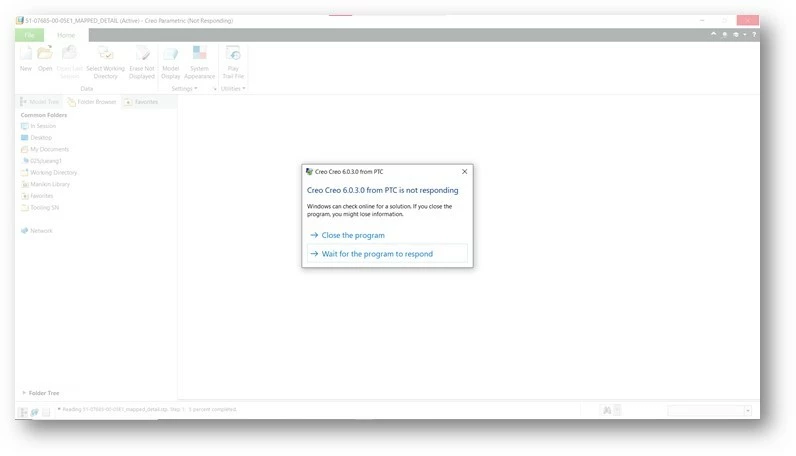

Cannot open large STP file, Creo not responding.
I am using Creo Parametric 6.0.3.0

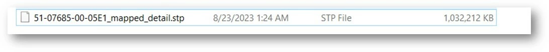

I have data file type .STP, the size about 1000 MB
when I open by Creo Parametric, there are warning box show Creo is not responding.
Do you have solution for open the large file or extract file(Assembly paty) to small size (sub part) ?
Anyone who have experience about this issue, kindly guide me.

1 gig step file is big. When you get the not responding, that doesn't mean creo has crashed. If it can be opened, it will likely take a long time if it opens.
I would try to let it run overnight. It may never open.

Adding to what has already been shared, a step file of size 1 Gb is likely to take a long time to load.
Can you edit the stp file with notepad? You will see in the header what CAD it is from. From this you can have a look to Creo compatibility matrix and if supported, you may challenge your provider and offer to get the native file instead (better quality and hopeful lower footprint).
Additionally in order to check the STEP file integrity you may download and install STEP Analyzer. It is a free.
