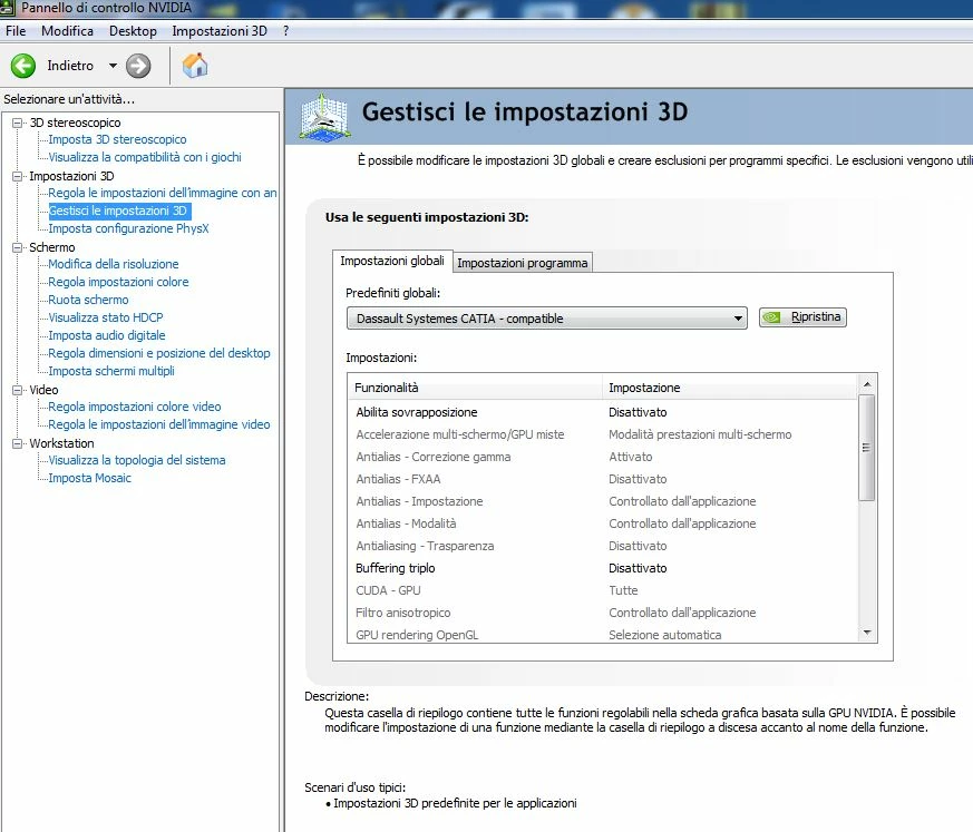

At work my workstation has a Nvidia Quadro K4000 3D card and I wonder which settings I can put for ProE WF5.
Before I had the Basic Profile in 3D settings tab, after I've put the only option inherent with 3D cad, that is "Dassault Systemes CATIA - compatible".
(Look at picture)
It is right? There are other options to setting?

Hello Giulio,
specific profiles are added by NVidia for products they know certain settings are necessary to overcome issues with the this software.
Since they know the PTC applications, the absence can be interpreted as "there is no need for specific settings to overcome any known problems".
In the PTC database there is an article about this:
http://www.ptc.com/appserver/cs/view/solution.jsp?n=CS24038
