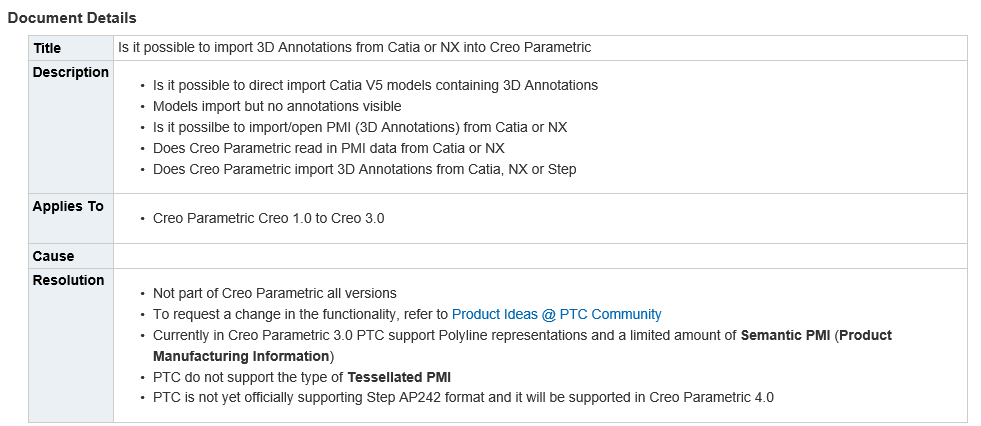

can you post a screenshot of the page?

here we go

That´s what I was expecting. Let´s wait for Creo 4.0.
