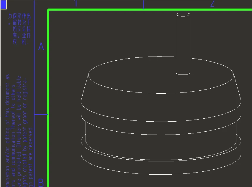

CGM created from a drawing have splits and curves
The cgm file created from drawing using File->Save a Copy..*.cgm is not equal to the drawing opened in ProE.
The cgm has splits in between lines and extra curves.
Please find the snapshot attached
Is there any settings which can resolve the issue.

Wildfire 3.0 M250
Setting intf2d_out_cgm_ver to 3 (default is 1) in config.pro is making some difference, but cgm created is having disjoint edges and there are curves
Nov 30, 2011 10:58 AM UTC
Could you provide a drawing sheet?
